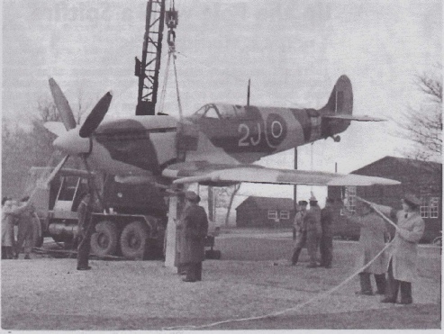

  1. Build a reinforced concrete pedestal, strong enough to support approximately 3 tons of Spitfire at an angle of 5° nose down and 10° bank to port, and able to withstand vibrations caused by gusts of wind up to 90 miles per hour attacking the aircraft.
  2. Build a "U" frame which would span from wing root to wing root, fixed by special bolts to the wing attachment points.
  3. Lift the aircraft at an angle onto the pedestal and secure it by the 31 holding down bolts.
  4. Fasten bracing wires from nose to pedestal, tail to pedestal and wings to pedestal, to give an added bonus of strength and security.

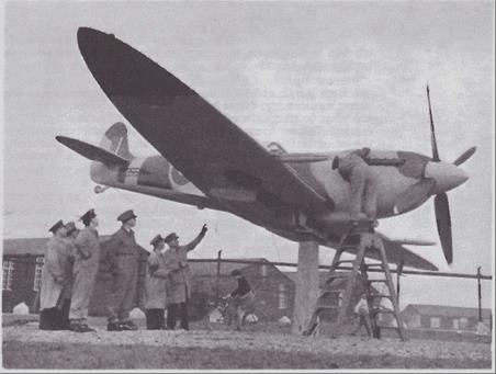

At This stage the airfield construction boys, often referred to as "A.C.B.s", really got to work. They laid a steel mesh "matting" of 3/4 inch steel rods, nine feet square, and approximately one foot deep, with rods crossing every nine inches. Four one inch rods, which originated at the base of the mat, were left protruding in the centre, whilst "Ready Mix" concrete was poured in and vibrated with a pneumatic tool, known as a "Poker Vibrator". This was to eliminate internal pockets of air which might have formed in the concrete as it set.
During the next few days, white the concrete was setting, the wood spoilers of Station Workshops made the wooden shutters (moulds) for the tapered column, upon which the Spitfire was to sit. Meanwhile, the blacksmith, and I must say, a blacker smith I have yet to meet, made the reinforcing mesh for the column. An interest­ing point here, is that the four threaded rods in the column, to which the mounting plate is bolted, are not one-piece rods passing right through the pedestal, but are actually each composed of three pieces, the first of which I have already mentioned. The idea is that allowance must be made for the aircraft vibrating during winds, which might well cause a rigid column to crack. These rods were positioned in the shutters and the shutters erected and strutted to prevent movement, then finally fitted with concrete and allowed to set. In the meantime, those noble exponents of crib, snooker, and darts, the highly skilled tradesmen of Station Workshops, had not been idle (which was none of their own doing). The machine tool setter and operator had manufactured all the special bolts, links, pins, etc., and the blacksmith, a "U" shaped frame of welded steel plate, which would later be fastened to the aircraft wing root bolts, and, ultimately, to the mounting base. The general fitter had prepared the aircraft and mounting slings and finally, the Spitfire had been painted in its authentic World War II camouflage.

To cut a long story even shorter, one fine autumn day in 1962, a ten ton mobile crane arrived from No. 7 M.U. Quedgley. The aircraft was skilfully lifted into position by the operator and, due to the exact positioning of the lifting slings giving an angle of 5° nose down and 10° list to port, it slid into place without any difficulty, and was soon firmly bolted down.
The bracing wires were then measured and taken to an engineer­ing firm in Bridgwater, who machine swaged the adjustable turn-buckles onto the ends.
Both BBC. and I.T.V. had expressed a desire to televise the mounting ceremony. Never having done this job before, we thought it prudent to lift the aircraft off and remount it for them the follow­ing day. This was to avoid having any amusing incidents or accidents shown on their candid cameras. After all, if Chiefy had trapped his fingers, I doubt if even the most rabid "kitchen sink" producer would have recorded what he said!
I must say, however, that the coverage given by them, was excellent. They preceded the show with true films of the Battle of Britain and then showed the aircraft being placed in position.
I have often heard visitors remark how impressive the Spitfire looks on its mounting. This, I am sure you will all agree, is a tribute to the skilful manner in which the personnel of Station Workshops and the detachment of No. 5004 Airfield Construction Branch carried out the job.
